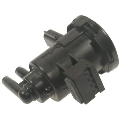

    When it does it pop the hood and see if you can isolate the sound.
    The Purge Control Valve/Solenoid can click, so you might locate it and check that first.
    I am not sure on a TJ exactly where it's located (possibly near the firewall on the passenger side) but it should look something like this.
